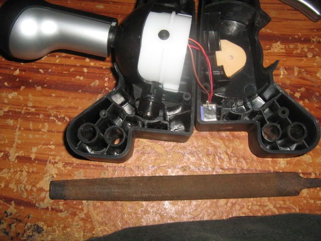

OK DID MY FIRST MOD,
got annoyed with the sound of the H- shifter, so it needed to be quietened
tools
small phillips screwdriver, and a file
unscrewed the shifter, popped the stick and white thingy right out and simply filed down the 2 bumps the little silver ball runs over, and reassemble,
now much better, seems alot nicer to move also, took me all of about 10min

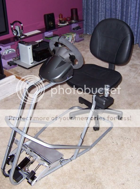

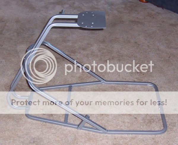

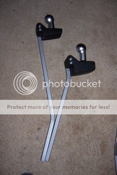

got my Shi# together and finished of the RU-GT2 cockpit
Naked (cockpit)
Fully dressed - H patten shifter
Ive created 2 shifter posts, the H patten sits low, very similar to a normal gear position in a centre console and the Sequential sits closer to the wheel.

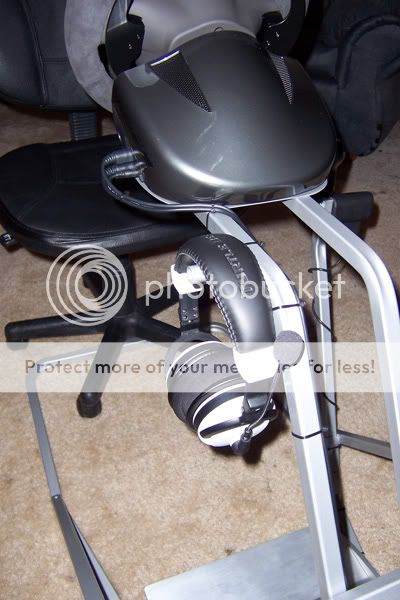

Oh, dont forget the hanger for the Turtle Beach H/Set
Now all Ive got to do is turn it on.... happy racing

Post by TEEROY 34 on Thu Jun 30, 2011 3:39 pm
HOw much for one RU!!?
top job mate!

Post by iWolf on Thu Jun 30, 2011 3:51 pm
Nice job RU, it looks the biz.
Ain't it amazing the sins you can cover with a good coat of paint. Wink

Post by RU four 86 on Thu Jun 30, 2011 3:53 pm
funny thing Mr T, it cost me a can of spray paint and a couple of bolts.
an old (roof rack) client, owed my a few favours, so they bent and supplied the steel for free!
didn't use all the bits,
I just made it to measure, re bent a few angles, a couple of bolts n screws before welding it.
I have a pdf of the plan, if anyone want it, just pm me

Post by RU four 86 on Mon Jul 04, 2011 2:10 pm
@ stoner, Im going to have to give that shifter mod a go, that clicking given me the Shi#s too....

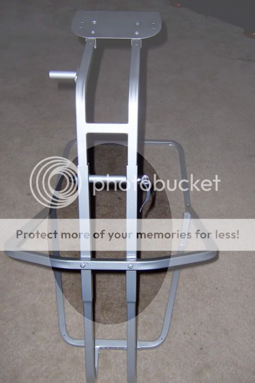

Post by RU four 86 on Thu Jul 07, 2011 3:26 pm
RU-GT2 verII
need to go back to the body shop for a cut and tuck!, basically the wheel position was too low.
so I cut the diagonals above the support bar and placed a over-sleeve, re-braced it, and made it adjustable, thxs to a quick release bike axle.
Ive now got up to an extra 100mm height adjustment, but Ive set it to 50mm at this point
